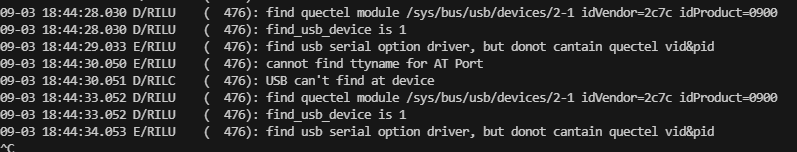

提示一直找不到AT PORT,我看ttyUSB和说明书确实有点差异,是不是固件的问题。
1 个赞
AT 口没有找到。
ttyUSB1 和ttyUSB0 都不是。
option.c 有问题,正常应该是5个ttyUSB。
嗯,多谢,是VID加的不够导致的。

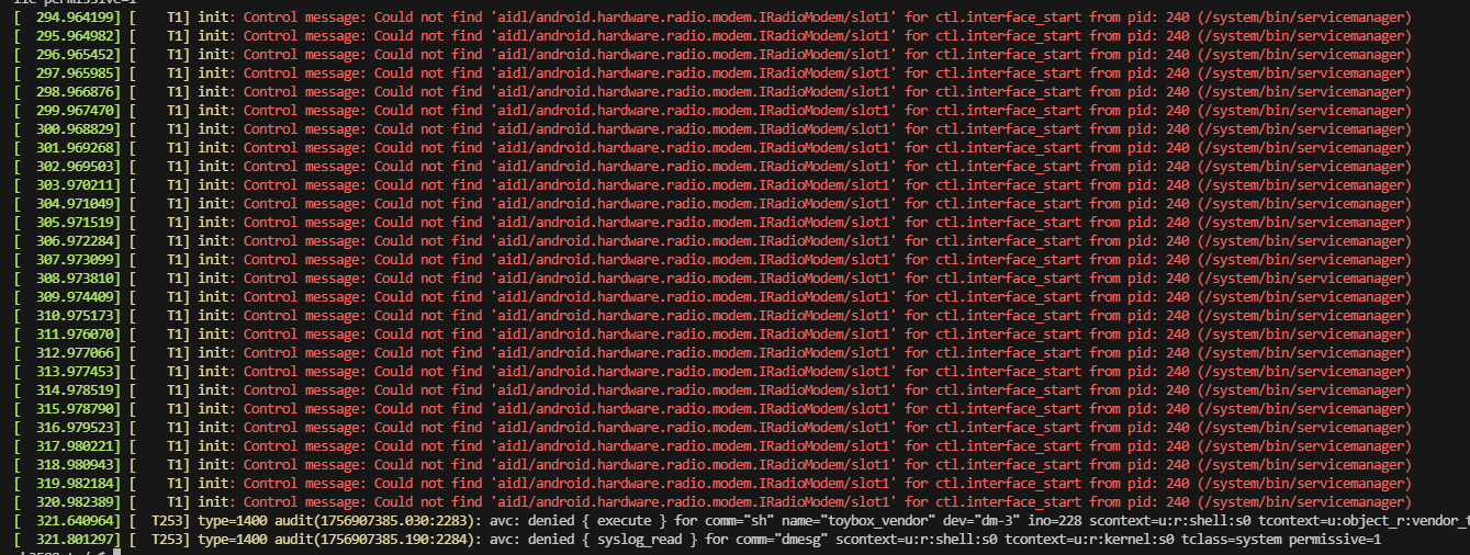

没有服务
09-03 22:02:47.543 1 1 E init : Control message: Could not find ‘aidl/android.hardware.radio.modem.IRadioModem/slot1’ for ctl.interface_start from pid: 240 (/system/bin/servicemanager)
09-03 22:02:43.968 3242 3242 W ServiceManager: Waited one second for android.hardware.radio.modem.IRadioModem/slot1 (is service started? are binder threads started and available?)
09-03 22:02:43.968 240 240 I servicemanager: Since ‘android.hardware.radio.modem.IRadioModem/slot1’ could not be found, trying to start it as a lazy AIDL service
09-03 22:02:43.969 240 5261 W libc : Unable to set property “ctl.interface_start” to “aidl/android.hardware.radio.modem.IRadioModem/slot1”: error code: 0x20
09-03 22:02:43.969 240 5261 I servicemanager: Tried to start aidl service android.hardware.radio.modem.IRadioModem/slot1 as a lazy service, but was unable to. Usually this happens when a service is not installed, but if the service is intended to be used as a lazy service, then it may be configured incorrectly.
09-03 22:02:48.544 1 1 E init : Control message: Could not find ‘aidl/android.hardware.radio.modem.IRadioModem/slot1’ for ctl.interface_start from pid: 240 (/system/bin/servicemanager)

HAL 没有跑起来,请问这个一般是哪个地方出问题了。

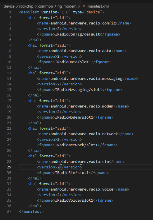

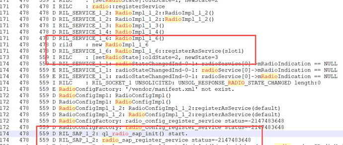

Android 13 不用配置<version>2</version>.

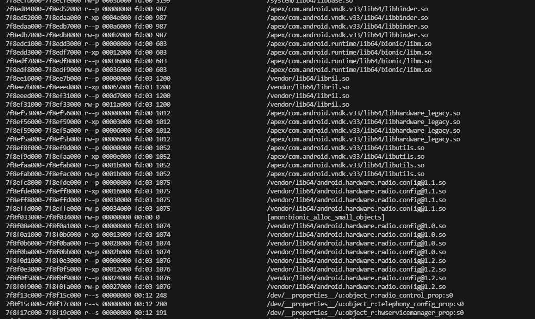

提供下日志,logcat -b all

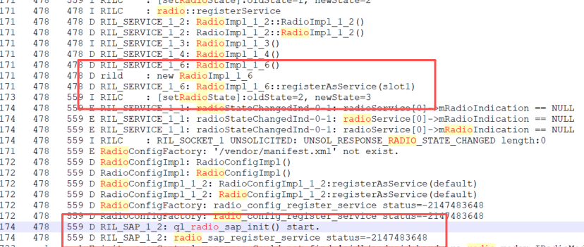

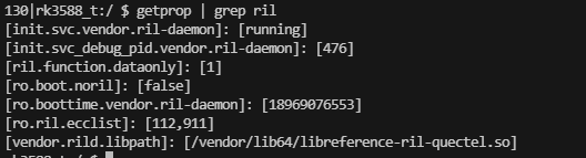

先确保rild 运行了
有运行起来了,这个是去掉了2 配置时的日志。
quectel.txt (4.9 MB)
ps -efl | grep -i radio 看看。
有两个服务要删掉.
知道原因了,多谢指点。
你们客服提供的驱动无法加载;替换成github上的库就正常了。 GitHub - QuectelWB/Quectel_RIL at aidl

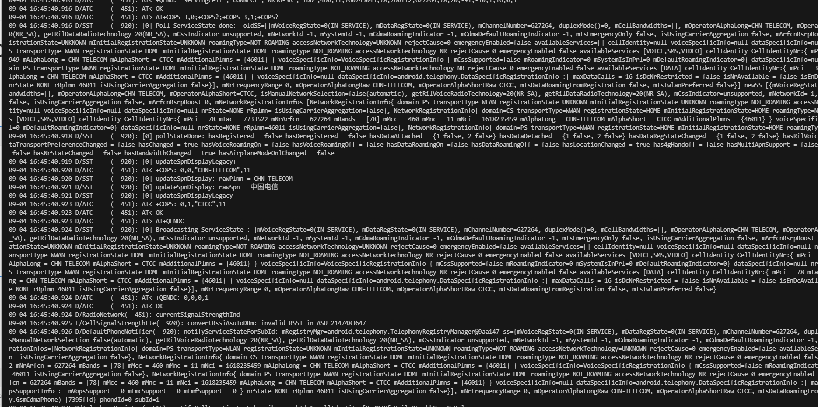

同比手机信号少了2格,请问这个有调试指导文档嘛?
看RSRP -91,这个信号其实也不怎么好
