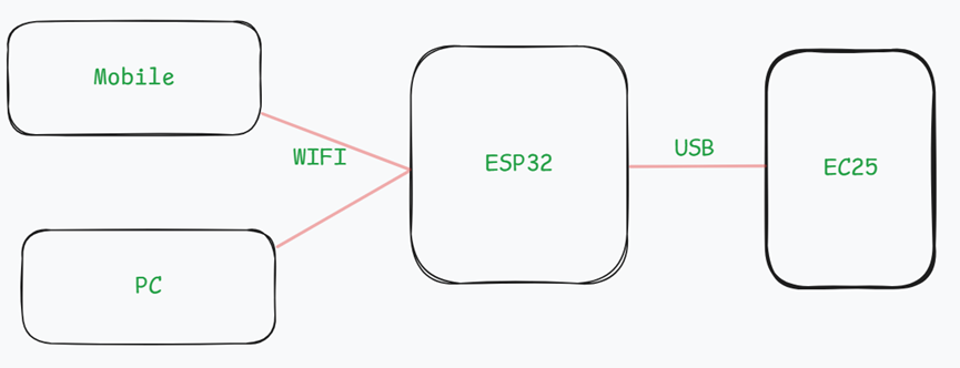

目标
希望PC或者手机可以直接使用ESP32和移远模组当作一个路由器使用。

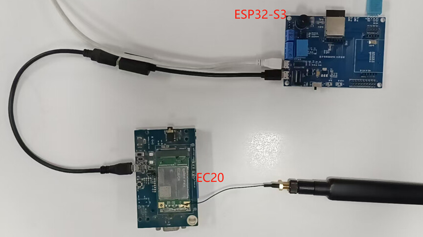

硬件连接
这个板子是合肥墨子号的ESP32的开发板。

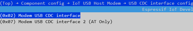

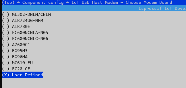

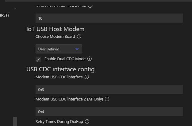

idf.py menuconfig

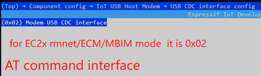

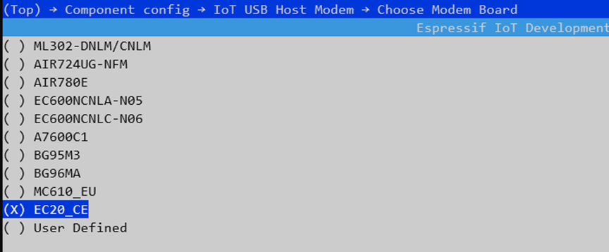

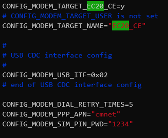

其实修改的就是
sdkconfig 里的这些配置
编译下载到ESP32里。

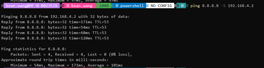

验证和测试
PPP 拨号成功

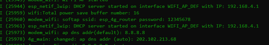

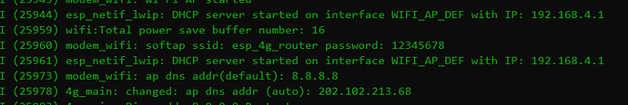

ESP32 使能了softAP ,创建热点

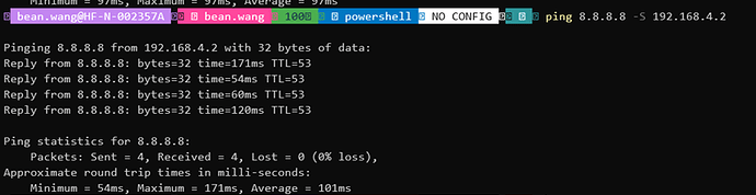

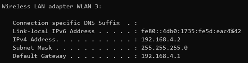

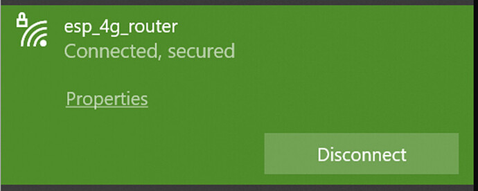

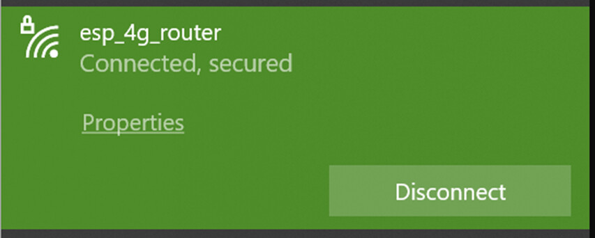

PC 和手机验证

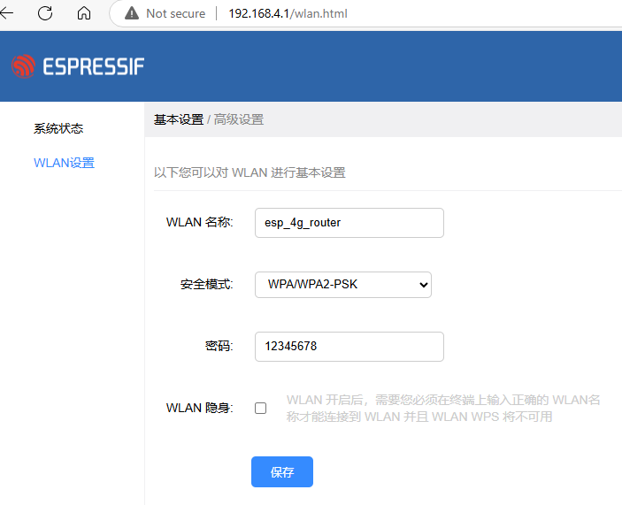

默认创建的热点是esp_4g_router,密码是12345678
PC 上的地址

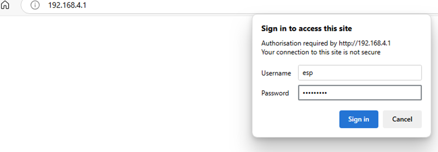

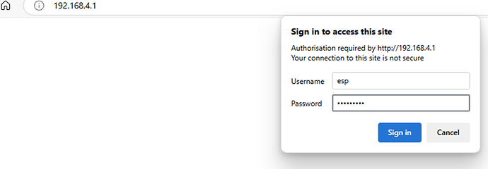

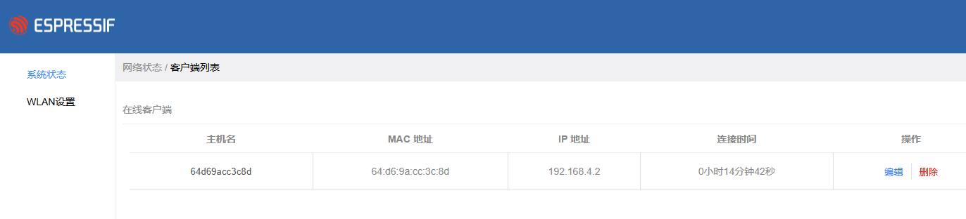

ESP32 的WEBUI

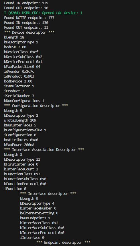

Found IN endpoint: 132
Found OUT endpoint: 3

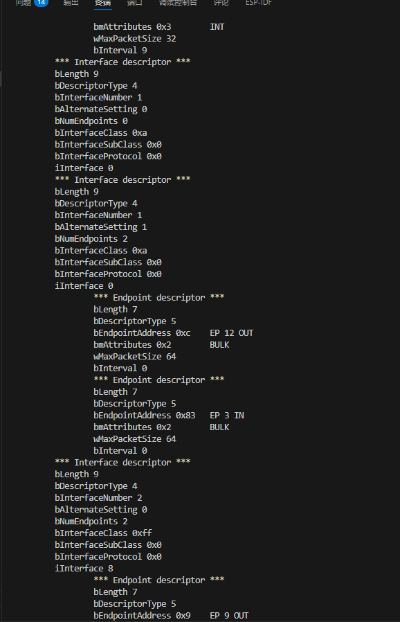

*** Device descriptor ***

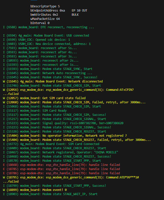

I (6694) modem_board: DTE reconnect, reconnecting ...
I (6699) 4g_main: Modem Board Event: USB connected
I (6704) USBH_CDC: Opened cdc device: 1
I (6707) USBH_CDC: New device connected, address: 1
I (7699) modem_board: reconnect after 5s...
I (8699) modem_board: reconnect after 4s...
I (9699) modem_board: reconnect after 3s...
I (10699) modem_board: reconnect after 2s...
I (11699) modem_board: reconnect after 1s...
I (11699) modem_board: Modem state STAGE_SYNC, Start
I (11713) modem_board: Network Auto reconnecting ...
I (11713) modem_board: Modem state STAGE_SYNC, Success!
W (11713) 4g_main: Modem Board Event: Network disconnected
I (11813) modem_board: Modem state STAGE_CHECK_SIM, Start
I (11815) modem_board: SIM Card Ready
I (11816) modem_board: Modem state STAGE_CHECK_SIM, Success!
I (11816) 4g_main: Modem Board Event: SIM Card Connected
I (11916) modem_board: Modem state STAGE_CHECK_SIGNAL, Start
I (11918) modem_board: Signal quality: rssi=31, ber=99
I (11918) modem_board: Modem state STAGE_CHECK_SIGNAL, Success!
I (12020) modem_board: Modem state STAGE_CHECK_REGIST, Start
I (12023) modem_board: Network registered, Operator: "CHN-CT"
I (12024) modem_board: Modem state STAGE_CHECK_REGIST, Success!
I (12125) modem_board: Modem state STAGE_START_PPP, Start
E (12133) esp-modem-dte: esp_dte_handle_line(79): handle line failed
E (22129) esp-modem-dte: esp_modem_dte_send_cmd(278): process command timeout
 response timeoutem_dce: esp_modem_dce_generic_command(26): Command:ATD*99***1#
I (22136) modem_board: Modem state STAGE_START_PPP, Success!
W (22137) modem_board: Modem event! 0

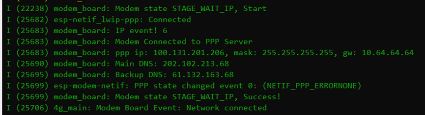

I (22238) modem_board: Modem state STAGE_WAIT_IP, Start
I (25682) esp-netif_lwip-ppp: Connected
I (25683) modem_board: IP event! 6
I (25683) modem_board: Modem Connected to PPP Server
I (25683) modem_board: ppp ip: 100.131.201.206, mask: 255.255.255.255, gw: 10.64.64.64
I (25690) modem_board: Main DNS: 202.102.213.68
I (25695) modem_board: Backup DNS: 61.132.163.68
I (25699) esp-modem-netif: PPP state changed event 0: (NETIF_PPP_ERRORNONE)
I (25699) modem_board: Modem state STAGE_WAIT_IP, Success!
I (25706) 4g_main: Modem Board Event: Network connected
I (25706) 4g_router_server: ssid : Can't find in NVS!

I (25943) modem_wifi: Wi-Fi AP started
I (25944) esp_netif_lwip: DHCP server started on interface WIFI_AP_DEF with IP: 192.168.4.1
I (25959) wifi:Total power save buffer number: 16
I (25960) modem_wifi: softap ssid: esp_4g_router password: 12345678
I (25961) esp_netif_lwip: DHCP server started on interface WIFI_AP_DEF with IP: 192.168.4.1
I (25973) modem_wifi: ap dns addr(default): 8.8.8.8
I (25978) 4g_main: changed: ap dns addr (auto): 202.102.213.68
I (25983) 4g_main: Ping addr 8.8.8.8 Restart..
I (26111) 4g_main: 64 bytes from 8.8.8.8 icmp_seq=1 ttl=54 time=123 ms

换成EC200U
log
Found IN endpoint: 138
Found OUT endpoint: 7
I (6232) USBH_CDC: Opened cdc device: 1
Found OUT endpoint: 2
bLength 18
bDescriptorType 1
bcdUSB 2.00
bDeviceClass 0x0
bDeviceSubClass 0x0
bDeviceProtocol 0x0
bMaxPacketSize0 64
idVendor 0x2c7c
idProduct 0x901
bcdDevice 3.10
iManufacturer 1
iProduct 2
iSerialNumber 3
bNumConfigurations 1
*** Configuration descriptor ***
bLength 9
bDescriptorType 2
wTotalLength 263
bNumInterfaces 9
bConfigurationValue 1
iConfiguration 0
bmAttributes 0xe0
bMaxPower 400mA
*** Interface Association Descriptor ***
bLength 8
bDescriptorType 11
bFirstInterface 0
bInterfaceCount 2
bFunctionClass 0x2
bFunctionSubClass 0x6
bFunctionProtocol 0x0
iFunction 4
        *** Interface descriptor ***
        bLength 9
        bDescriptorType 4
        bInterfaceNumber 0
        bAlternateSetting 0
        bNumEndpoints 1
        bInterfaceClass 0x2
        bInterfaceSubClass 0x6
        bInterfaceProtocol 0x0
        iInterface 6
                *** Endpoint descriptor ***
                bLength 7
                bDescriptorType 5
                bEndpointAddress 0x81   EP 1 IN
                bmAttributes 0x3        INT
                wMaxPacketSize 16
                bInterval 32
        bLength 9
        bDescriptorType 4
        bInterfaceNumber 1
        bAlternateSetting 0
        bNumEndpoints 0
        bInterfaceClass 0xa
        bInterfaceSubClass 0x0
        iInterface 0
        bLength 9
        bDescriptorType 4
        bInterfaceNumber 1
        bAlternateSetting 1
        bNumEndpoints 2
        bInterfaceClass 0xa
        iInterface 5
                bLength 7
                bDescriptorType 5
                bEndpointAddress 0x82   EP 2 IN
                bmAttributes 0x2        BULK
                wMaxPacketSize 64
                bInterval 0
                bLength 7
                bDescriptorType 5
                bEndpointAddress 0x1    EP 1 OUT
                wMaxPacketSize 64
                bInterval 0
        bLength 9
        bDescriptorType 4
        bInterfaceNumber 2
        bAlternateSetting 0
        bNumEndpoints 3
        bInterfaceClass 0xff
        iInterface 8
                bLength 7
                bDescriptorType 5
                bEndpointAddress 0x84   EP 4 IN
                wMaxPacketSize 64
                bInterval 0
                bLength 7
                bDescriptorType 5
                bEndpointAddress 0x2    EP 2 OUT
                wMaxPacketSize 64
                bInterval 0
                bLength 7
                bDescriptorType 5
                bEndpointAddress 0x83   EP 3 IN
                wMaxPacketSize 64
                bInterval 32
        bLength 9
        bDescriptorType 4
        bInterfaceNumber 3
        bAlternateSetting 0
        bNumEndpoints 2
        iInterface 8
                bLength 7
                bDescriptorType 5
                bEndpointAddress 0x85   EP 5 IN
                wMaxPacketSize 64
                bInterval 0
                bLength 7
                bDescriptorType 5
                bEndpointAddress 0x3    EP 3 OUT
                wMaxPacketSize 64
                bInterval 0
        bLength 9
        bDescriptorType 4
        bInterfaceNumber 4
        bAlternateSetting 0
        bNumEndpoints 2
        iInterface 8
                bLength 7
                bDescriptorType 5
                bEndpointAddress 0x86   EP 6 IN
                wMaxPacketSize 64
                bInterval 0
                bLength 7
                bDescriptorType 5
                bEndpointAddress 0x4    EP 4 OUT
                wMaxPacketSize 64
                bInterval 0
        bLength 9
        bDescriptorType 4
        bInterfaceNumber 5
        bAlternateSetting 0
        bNumEndpoints 2
        iInterface 8
                bLength 7
                bDescriptorType 5
                bEndpointAddress 0x87   EP 7 IN
                wMaxPacketSize 64
                bInterval 0
                bLength 7
                bDescriptorType 5
                bEndpointAddress 0x5    EP 5 OUT
                wMaxPacketSize 64
                bInterval 0
        bLength 9
        bDescriptorType 4
        bInterfaceNumber 6
        bAlternateSetting 0
        bNumEndpoints 2
        iInterface 8
                bLength 7
                bDescriptorType 5
                bEndpointAddress 0x88   EP 8 IN
                wMaxPacketSize 64
                bInterval 0
                bLength 7
                bDescriptorType 5
                bEndpointAddress 0x6    EP 6 OUT
                wMaxPacketSize 64
                bInterval 0
        bLength 9
        bDescriptorType 4
        bInterfaceNumber 7
        bAlternateSetting 0
        bNumEndpoints 3
        iInterface 8
                bLength 7
                bDescriptorType 5
                bEndpointAddress 0x8a   EP 10 IN
                wMaxPacketSize 64
                bInterval 0
                bLength 7
                bDescriptorType 5
                bEndpointAddress 0x7    EP 7 OUT
                wMaxPacketSize 64
                bInterval 0
                bLength 7
                bDescriptorType 5
                bEndpointAddress 0x89   EP 9 IN
                wMaxPacketSize 64
                bInterval 32
        bLength 9
        bDescriptorType 4
        bInterfaceNumber 8
        bAlternateSetting 0
        bNumEndpoints 2
        iInterface 8
                bLength 7
                bDescriptorType 5
                bEndpointAddress 0x8b   EP 11 IN
                wMaxPacketSize 64
                bInterval 0
                bLength 7
                bDescriptorType 5
                bEndpointAddress 0x8    EP 8 OUT
                wMaxPacketSize 64
                bInterval 0
I (6736) modem_board: DTE reconnect, reconnecting ...
I (6741) 4g_main: Modem Board Event: USB connected
I (6746) USBH_CDC: Opened cdc device: 1
I (6749) USBH_CDC: New device connected, address: 1
I (7741) modem_board: reconnect after 5s...
I (8741) modem_board: reconnect after 4s...
I (9741) modem_board: reconnect after 3s...
I (10741) modem_board: reconnect after 2s...
I (11741) modem_board: reconnect after 1s...
I (11741) modem_board: Modem state STAGE_SYNC, Start
I (11773) modem_board: Network Auto reconnecting ...
I (11773) modem_board: Modem state STAGE_SYNC, Success!
W (11773) 4g_main: Modem Board Event: Network disconnected
I (11873) modem_board: Modem state STAGE_CHECK_SIM, Start
I (11884) modem_board: SIM Card Ready
I (11884) modem_board: Modem state STAGE_CHECK_SIM, Success!
I (11884) 4g_main: Modem Board Event: SIM Card Connected
I (11985) modem_board: Modem state STAGE_CHECK_SIGNAL, Start
I (11997) modem_board: Signal quality: rssi=30, ber=99
I (11998) modem_board: Modem state STAGE_CHECK_SIGNAL, Success!
I (12098) modem_board: Modem state STAGE_CHECK_REGIST, Start
I (12111) modem_board: Network registered, Operator: "CHINA MOBILE"
I (12111) modem_board: Modem state STAGE_CHECK_REGIST, Success!
I (12211) modem_board: Modem state STAGE_START_PPP, Start
I (12242) modem_board: Modem state STAGE_START_PPP, Success!
W (12243) modem_board: Modem event! 0
I (12343) modem_board: Modem state STAGE_WAIT_IP, Start
I (18400) esp-netif_lwip-ppp: Connected
I (18400) modem_board: IP event! 6
I (18400) modem_board: Modem Connected to PPP Server
I (18400) modem_board: ppp ip: 10.96.61.137, mask: 255.255.255.255, gw: 192.168.0.1
I (18408) modem_board: Main DNS: 211.138.180.4
I (18412) modem_board: Backup DNS: 211.138.180.5
I (18416) esp-modem-netif: PPP state changed event 0: (NETIF_PPP_ERRORNONE)
I (18416) modem_board: Modem state STAGE_WAIT_IP, Success!
I (18423) 4g_main: Modem Board Event: Network connected

I (18695) esp_netif_lwip: DHCP server started on interface WIFI_AP_DEF with IP: 192.168.4.1
I (18707) modem_wifi: ap dns addr(default): 8.8.8.8
I (18726) 4g_main: rssi=30, ber=99
I (18726) 4g_main: changed: ap dns addr (auto): 211.138.180.4
I (18726) 4g_main: Ping addr 8.8.8.8 Restart..
W (20728) 4g_main: From 8.8.8.8 icmp_seq=1 timeout
I (28742) 4g_main: rssi=30, ber=99
I (28742) 4g_main: Ping addr 8.8.8.8 Restart..
I (28975) 4g_main: 64 bytes from 8.8.8.8 icmp_seq=1 ttl=52 time=232 ms
I (38756) 4g_main: rssi=30, ber=99
I (38756) 4g_main: Ping addr 8.8.8.8 Restart..
W (40756) 4g_main: From 8.8.8.8 icmp_seq=1 timeout
I (48769) 4g_main: rssi=31, ber=99
I (48769) 4g_main: Ping addr 8.8.8.8 Restart..
I (48970) 4g_main: 64 bytes from 8.8.8.8 icmp_seq=1 ttl=52 time=200 ms
同样是上面的代码,修改的地方
请问EC800E,怎么修改
EC800K 我应该是设置对了,cdc端口为0

还想问一下 EC200U的0x02 0x07这些值的来源?
通过USB描述信息能看出来吗?
知其然知其所以然
EC800E的AT口是intf 3 ; intf 4 是modem 口。
→ 这里改成0x03 和 0x04.
接口顺序在移远的驱动移植文档里有介绍。
天猫fae说EC800E没有USB描述符,又让买的EC801
一般只要了解一个接口顺序和对应的功能即可,这个USB接口描述符的详细说明除非要做非常底层的USB通信开发才需要。
天猫客户推荐EC801E主要是由于目前主要维护的是EC801E, 方便后续升级。
改成0x03 和 0x04也不可以呢!请问是什么原因呢
重新发下完整的日志。看日志是AT不通。
最好抓个usbtreeview看下USB接口顺序,或者接到Linux上,cat /sys/kernel/debug/usb/devices 看看。
EC800E.txt (24.6 KB)
usbtreeview.txt (9.3 KB)
接口还是应该是0x03 和0x04.
试过了还是不行呢,什么原因呢,EC800E-CN
不是论坛上能解决的啦。
