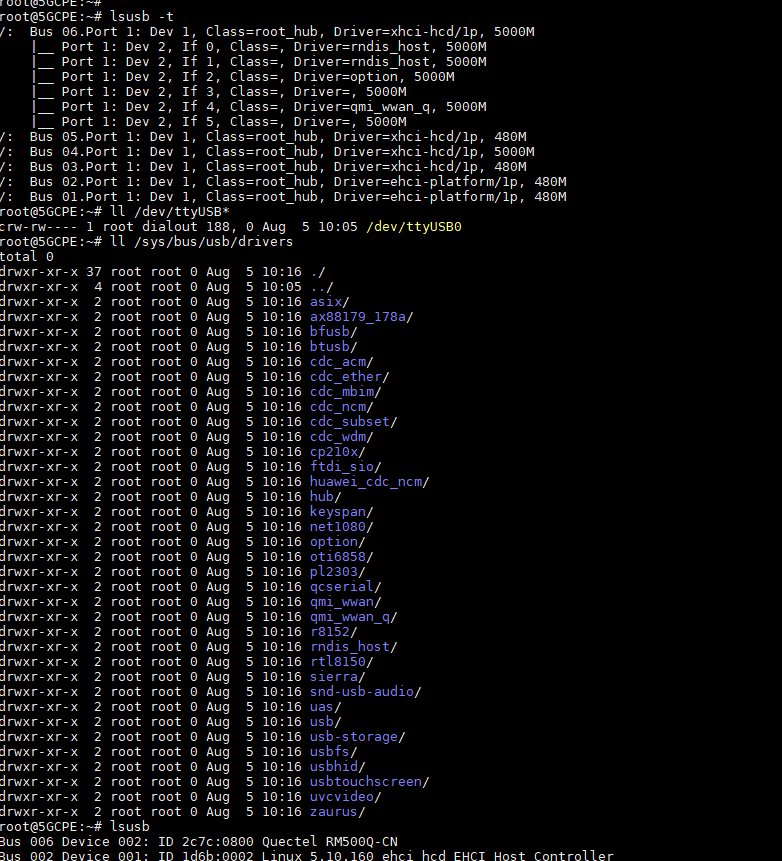

linux RM500Q 设置为usbnet,5之后,AT指令不响应也不能拨号入网,只剩下/dev/ttyUSB0
怀疑是模组现在应该是在RNDIS mode
这个情况重新烧录应该都不行
这个模组不支持usbnet 5
可以先试下改option.c
ls /lib/bus/usb-serial/drivers/ 看看
刚刚我的同事也找过了,修改的地方
	{ USB_DEVICE_INTERFACE_CLASS(QUECTEL_VENDOR_ID, 0x0800, 0xff), /* BG95 */
	  .driver_info = RSVD(4) | ZLP },
同时注释掉
#if 0   //Added by Quectel
	if (serial->dev->descriptor.idVendor == cpu_to_le16(0x2C7C)) {
 		//some interfaces can be used as USB Network device (ecm, rndis, mbim)
 		if (serial->interface->cur_altsetting->desc.bInterfaceClass != 0xFF) {
 			return -ENODEV;
 		//interface 4 can be used as USB Network device (qmi)
 		else if (serial->interface->cur_altsetting->desc.bInterfaceNumber >= 4) {
 			return -ENODEV;
#endif
