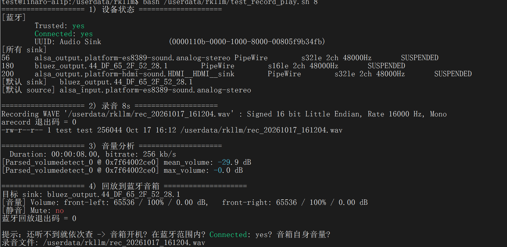

四、一键脚本:录音 + 回放(推荐)
把下面内容保存为 /userdata/rkllm/test_record_play.sh,先打印设备状态,再录音、分析音量、自动挑蓝牙 sink 回放,最后给出排查提示。
#!/usr/bin/env bash
# 录音 + 回放 手动测试脚本 (Quectel Pi M2 / RK3576)
# 用法: bash /userdata/rkllm/test_record_play.sh [录音秒数,默认8]
set -u
DUR="${1:-8}"
TS="$(date +%Y%m%d_%H%M%S)"
WAV="/userdata/rkllm/rec_${TS}.wav"
BT_MAC="44:DF:65:2F:52:28"
echo "==================== 1) 设备状态 ===================="
echo "[蓝牙]"
bluetoothctl info "$BT_MAC" 2>/dev/null | grep -E "Name:|Connected:|Audio Sink|Trusted:" \
  || echo "  未找到蓝牙设备信息(可能断连)"
echo "[所有 sink]"
pactl list short sinks 2>/dev/null || echo "  pactl 不可用"
echo "[默认 sink]   $(pactl get-default-sink 2>/dev/null)"
echo "[默认 source] $(pactl get-default-source 2>/dev/null)"
echo
echo "==================== 2) 录音 ${DUR}s ===================="
arecord -D default -f S16_LE -r 16000 -c 1 -d "$DUR" "$WAV"
RC=$?
echo "arecord 退出码 = $RC"
ls -l "$WAV" 2>/dev/null
if [ "$RC" -ne 0 ]; then echo "录音失败,退出。"; exit 1; fi
echo
echo "==================== 3) 音量分析 ===================="
ffmpeg -hide_banner -i "$WAV" -af volumedetect -f null - 2>&1 \
  | grep -E "mean_volume|max_volume|Duration" || true
echo
echo "==================== 4) 回放到蓝牙音箱 ===================="
BT_SINK="$(pactl list short sinks 2>/dev/null | awk '/bluez_output/{print $2; exit}')"
if [ -z "$BT_SINK" ]; then
  echo "未发现蓝牙 sink -> 尝试重连音箱..."
  bluetoothctl connect "$BT_MAC"
  sleep 1
fi
if [ -n "$BT_SINK" ]; then
  echo "目标 sink: $BT_SINK"
  pactl set-default-sink "$BT_SINK"
  echo "[音量] $(pactl get-sink-volume "$BT_SINK" 2>/dev/null | head -1)"
  echo "[静音] $(pactl get-sink-mute "$BT_SINK" 2>/dev/null)"
  pactl set-sink-mute "$BT_SINK" 0 2>/dev/null
  paplay --device="$BT_SINK" "$WAV"
  echo "蓝牙回放退出码 = $?"
else
  echo "仍无蓝牙 sink,改用默认输出:"
  paplay "$WAV"; echo "默认输出回放退出码 = $?"
fi
echo
echo "提示:还听不到就依次查 -> 音箱开机? 在蓝牙范围内? Connected: yes? 音箱自身音量?"
echo "录音文件: $WAV"
运行:
chmod +x /userdata/rkllm/test_record_play.sh
bash /userdata/rkllm/test_record_play.sh 8
