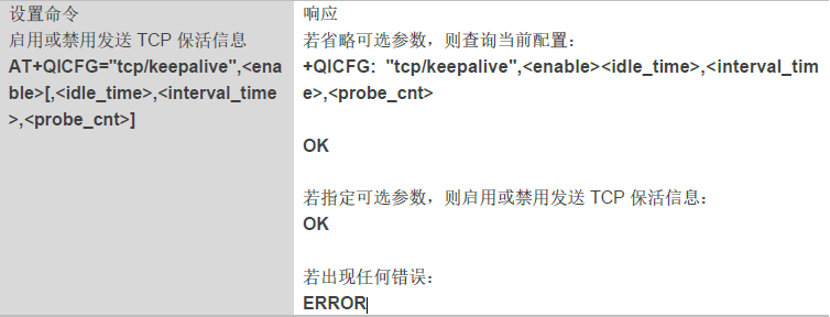

启用或禁用发送TCP 保活信息
AT+QICFG=“tcp/keepalive”,[,<idle_time>,<interval_time>,<probe_cnt>]
若省略可选参数,则查询当前配置:
+QICFG: “tcp/keepalive”,<idle_time>,<interval_time>,<probe_cnt>
