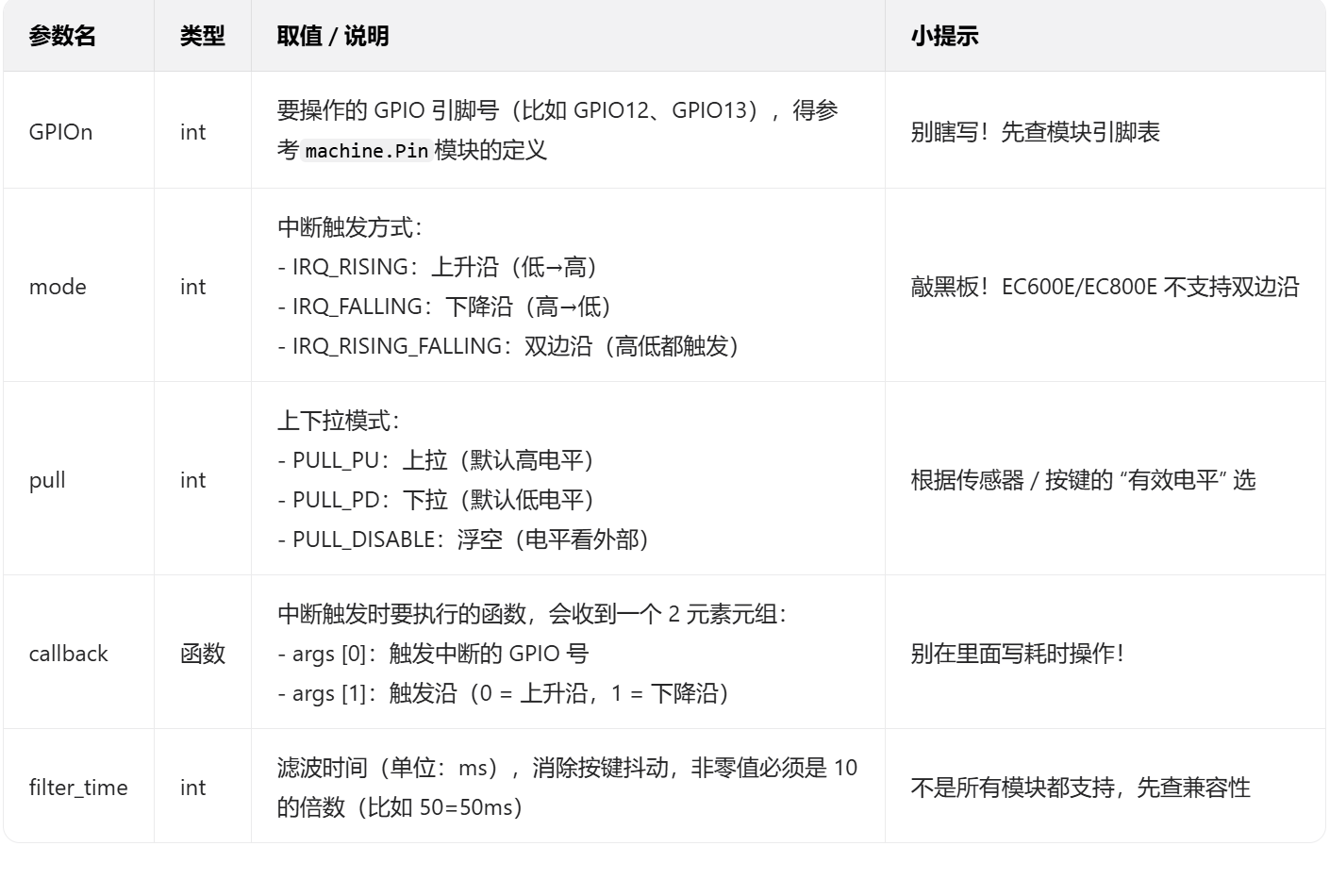

1. 类的初始化:5 个参数要记牢
创建中断对象的格式是这样的:class machine.ExtInt(GPIOn, mode, pull, callback, [filter_time])
每个参数啥意思?看这张表就懂:

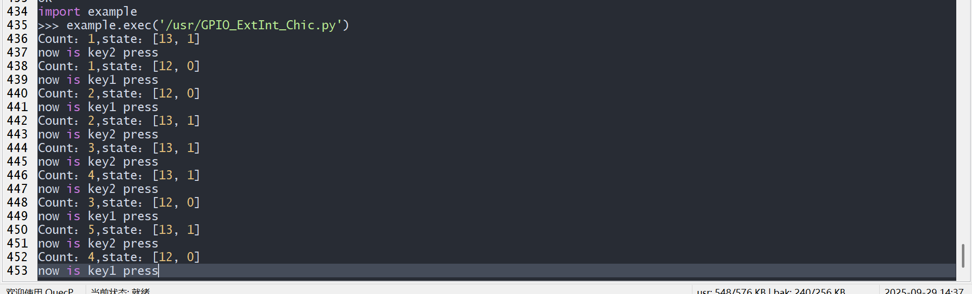

示例 1:双按键计数 —— 按一次记一次
需求:两个按键(key1 接 GPIO12,key2 接 GPIO13),按一次就打印计数和触发状态。
from machine import ExtInt
import utime
def fun1(args):
    global A
    A +=1
    print('Count:{},state:{}'.format(A, args))
    print("now is key1 press")
def fun2(args):
    global B
    B += 1
    print('Count:{},state:{}'.format(B, args))
    print("now is key2 press")
def main():
    global A
    global B
    A = 0
    B = 0
    extint1 = ExtInt(ExtInt.GPIO12, ExtInt.IRQ_RISING, ExtInt.PULL_PD, fun1)
    extint1.enable()
    extint2 = ExtInt(ExtInt.GPIO13, ExtInt.IRQ_FALLING, ExtInt.PULL_PU, fun2)
    extint2.enable()
    while True:
        utime.sleep_ms(5000)
        # print("。。。。。。。。。")
if __name__ == '__main__':
    main()
运行效果:按一次跳一次

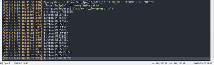

示例 2:长按检测 —— 按 3 秒才算 “长按”
需求:一个按键(接 GPIO13),短按打印 “RELEASED”,长按(超过 3 秒)打印 “LONG PRESS”。
核心逻辑:按下按键→触发回调→启动 3 秒定时器;如果 3 秒内松开→取消定时器(算短按);如果 3 秒后没松开→定时器触发,打印 “长按”。
import machine
import time
class Button:
    def __init__(self, pin, timer_id):
        self.pin = machine.ExtInt(pin, ExtInt.IRQ_RISING_FALLING, ExtInt.PULL_PU, self.callback)
        self.pin.enable()
        self.counter = 0
        self.prev_state = self.pin.read_level()
        self.debounce_count = 5
        self.click_timestamp = None
        self.long_press_time = 3000  # 1 second
        self.state = "UP"
        self.reported_long_press = False
        self.timer = machine.Timer(timer_id)
    def callback(self, pin):
        # Software counter debounce
        if self.pin.read_level() == self.prev_state:
            self.counter += 1
            if self.counter < self.debounce_count:
                return
        self.counter = 0
        current_time = time.ticks_ms()
        # Button pressed
        if self.pin.read_level() == 0:
            self.click_timestamp = current_time
            print("Button PRESSED")
            # Set timer for long press detection
            self.timer.start(period=self.long_press_time, mode=machine.Timer.ONE_SHOT, callback=self.long_press_handler)
        # Button released
        else:
            self.timer.stop()  # Cancel long press timer
            if self.click_timestamp:
                press_duration = time.ticks_diff(current_time, self.click_timestamp)
                if not self.reported_long_press:
                    if press_duration > self.long_press_time:
                        self.reported_long_press = True
                    else:
                        print("Button RELEASED")
                        self.state = "UP"
    def long_press_handler(self, timer):
            print("Button LONG PRESS")
#Usage
button = Button(ExtInt.GPIO13, timer_id=0)  # Button on GPIO 2, Timer 0
运行效果:短按 vs 长按一眼分
五、避坑指南:这些细节别踩雷!
1.模块兼容性要注意
● EC600E/EC800E 不支持双边沿触发(别写IRQ_RISING_FALLING),只能用单边沿;
● filter_time(滤波时间)不是所有模块都有,比如 EG912N/EC600M 支持,其他型号先查手册!
