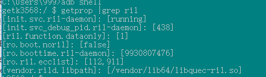

使用RK3568平台,系统安卓13版本,虚拟串口已经出来,插卡不出图标,radio日志一直报错:
03-19 10:45:56.247 438 562 D RIL_SERVICE_1_4: currentSignalStrengthInd 1974
03-19 10:45:56.247 438 562 E RIL_SERVICE_1_4: currentSignalStrengthInd_1_4: radioService[0]->mRadioIndication == NULL
03-19 10:45:56.247 438 562 E RIL_SERVICE_1_2: currentSignalStrengthInd_1_2: radioService[0]->mRadioIndication == NULL
03-19 10:45:56.247 438 562 E RIL_SERVICE_1_1: currentSignalStrengthInd: radioService[0]->mRadioIndication == NULL
03-19 10:45:56.247 438 562 I RILC : RIL_SOCKET_1 UNSOLICITED: UNSOL_SIGNAL_STRENGTH length:108

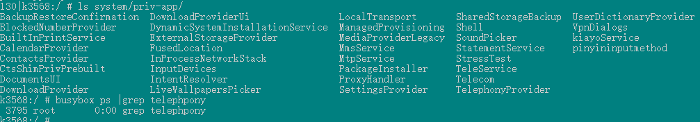

PHONE是否启动了
telephpony 的apk 是否加载了

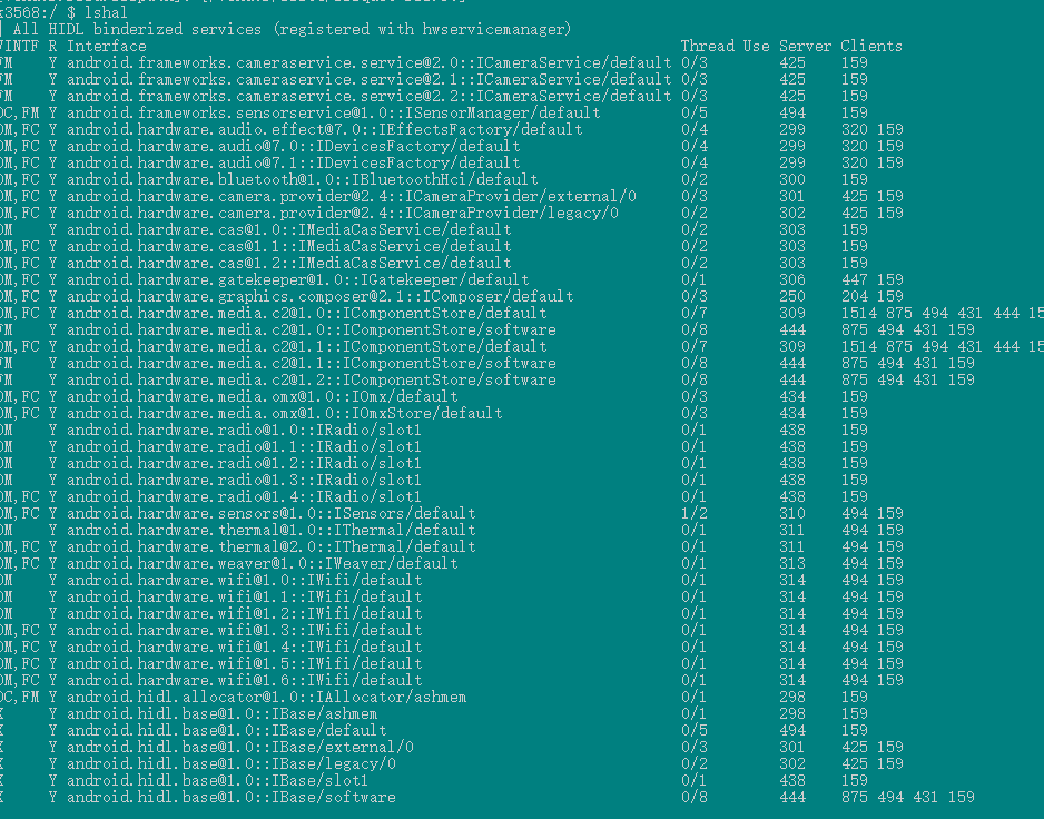

能不能发个完整的log看看。
logcat -b all
估计是没有连上。
