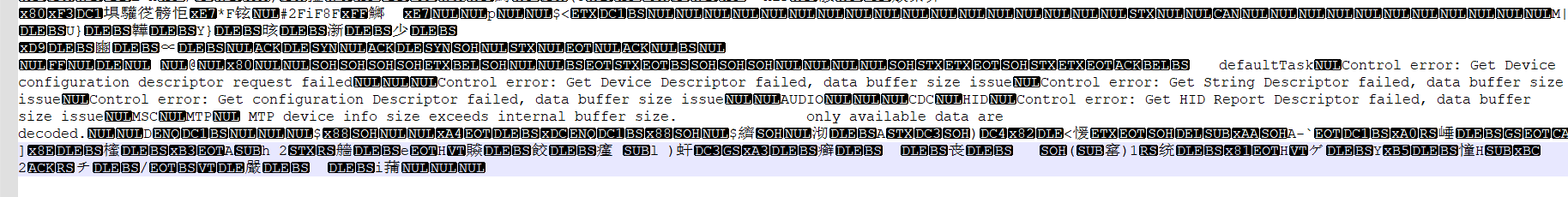

餦0\0??L’h\0/?)捦閈0?鱘?(O餦0衆0” hiF髅?敖桊丳 €?埧驩徔髈怇?F铉\0#2FiF8F鱜鏫0\0p\0\0$<\0\0\0\0\0\0\0\0\0\0\0\0\0\0\0\0\0\0\0\0\0\0\0\0\0\0\0\0\0\0M|U}韡Y}晐澵少?豳∝\0\0\0\0\0\0\0\0 \0\0 \0@\0€\0\0 \0\0\0\0\0\0  defaultTask\0Control error: Get Device configuration descriptor request failed\0\0\0Control error: Get Device Descriptor failed, data buffer size issue\0Control error: Get String Descriptor failed, data buffer size issue\0Control error: Get configuration Descriptor failed, data buffer size issue\0\0AUDIO\0\0\0CDC\0HID\0Control error: Get HID Report Descriptor failed, data buffer size issue\0MSC\0MTP\0 MTP device info size exceeds internal buffer size. only available data are decoded.\0\0D\0\0\0$?\0\0???\0$纃\0沏A)?<愋?A-`?崜]?櫁?Ah 2艢eH
贆餃瘽 l )虷?癣丧 (窰)1统?H
ゲY?憧H?2チ/
嚴i蒱\0\0\0
OK
+QHTTPREAD: 0
其他的是我的文件内容,这一段是报错defaultTask\0Control error: Get Device configuration descriptor request failed\0\0\0Control error: Get Device Descriptor failed, data buffer size issue\0Control error: Get String Descriptor failed, data buffer size issue\0Control error: Get configuration Descriptor failed, data buffer size issue\0\0AUDIO\0\0\0CDC\0HID\0Control error: Get HID Report Descriptor failed, data buffer size issue\0MSC\0MTP\0 MTP device info size exceeds internal buffer size. only available data are decoded

你好,这一段是报错defaultTask\0Control error: Get Device configuration descriptor request failed\0\0\0Control error: Get Device Descriptor failed, data buffer size issue\0Control error: Get String Descriptor failed, data buffer size issue\0Control error: Get configuration Descriptor failed, data buffer size issue\0\0AUDIO\0\0\0CDC\0HID\0Control error: Get HID Report Descriptor failed, data buffer size issue\0MSC\0MTP\0 MTP device info size exceeds internal buffer size. only available data are decoded,不是我文件的内容,这是我的URL:http://116.62.120.54:8080/firmware/AAAAA.bin

你的文件里面是有这段内容的 你可以再确认下
你好,我再次查看了一下文件内容,是的,里面确实有这段内容,不好意思,麻烦了,我现在将帖子改为已解决
